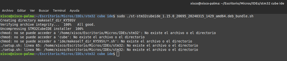

2024-03-24 1:53 AM
When the folder name of installer contains spaces, the installer tries to do a chmod to all words of the folder name.
Solved renaming the folder.
