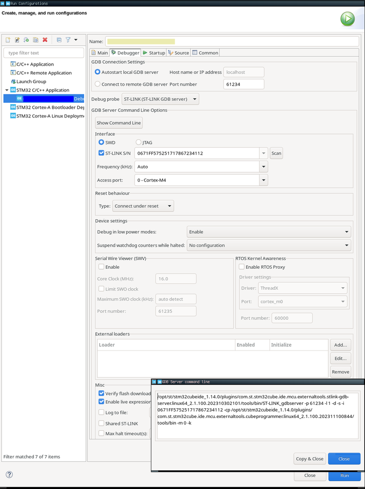

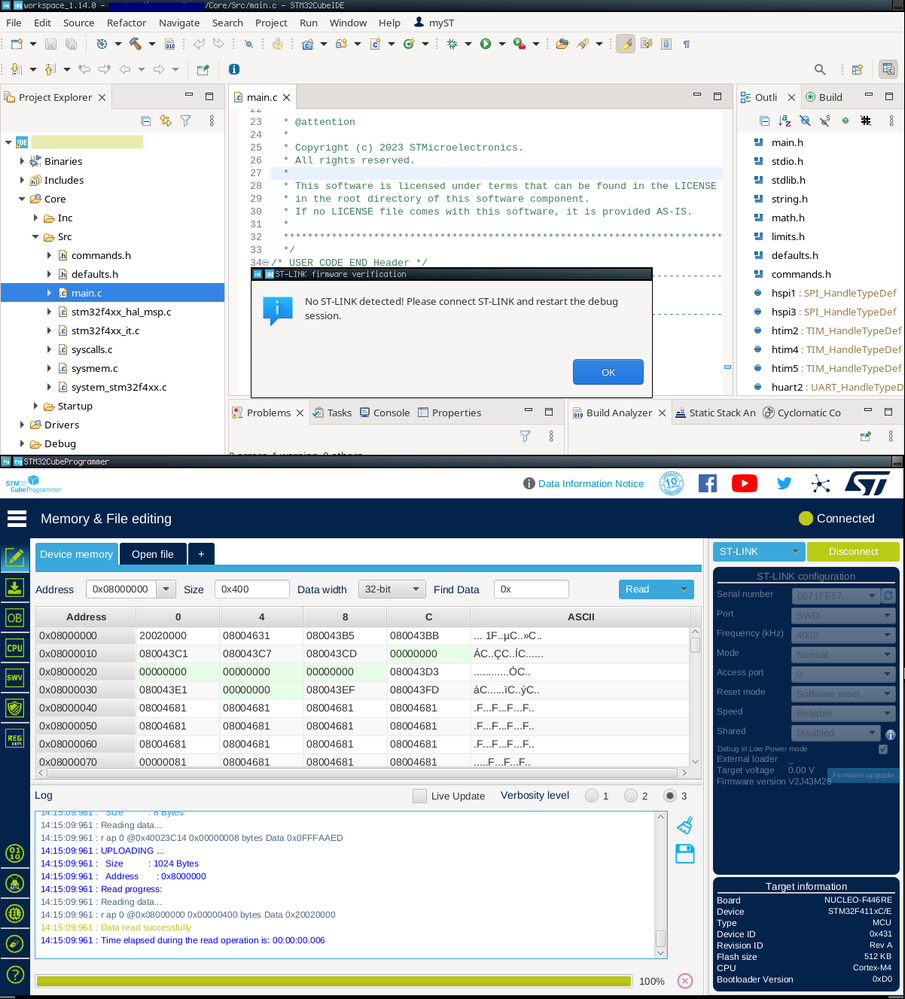

Because the CubeProgrammer detects the programmer and the target, I am confused why the IDE does not.
I made sure to refresh the S/N in the IDE "Run configuration". I used the Programmer and/or the IDE both as root and as normal user. I tried two linux computers, a gentoo (rolling, up to date) and a Mageia (version 8 and a fresh install of version 9). The IDE and Programmer are the generic linux binaries from ST.

Here is a what is happening in the IDE and the programmer (in this case both running at the same time but it's the same if only one of them is running).
Configuration of the IDE. I also tried the different options under Reset behaviour.
2023-12-26 8:14 AM - edited 2023-12-26 8:34 AM
Do not select a fixed S/N - except you know, that you need this...
...it only works with THIS number then; use : not selected S/N
+ in case you use a st-link V2 , in "usb-stick" version, its probably a counterfeit /not STM product,
STM32CubeIDE checking this and refuses to work, if not genuine stm chip inside the st-link.
