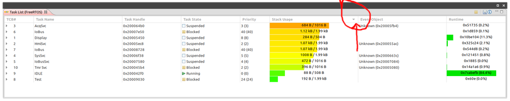

In Atollic TrueSTUDIO and the NXP/Freescale plugins for RTOS task aware debugging one could click the column headers to sort on stack usage or CPU usage. I would like for this to be functional again.
Besides that, the NXP plugin displays stack usage with a color bargraph indicating how much of the stack is in use. This is way more explicit than only numbers. It would be nice to have this in CubeStudio also

Ok, maybe i wasn't totally clear on the issue. I am aware of the fact that there are task statistics, but i would like for the *sorting options* in the task list (stack usage, resource usage) to be functional. And as a special request, display task usage and perhaps resource usage in a colored manner: (below is a screenshot of the NXP plugin)
