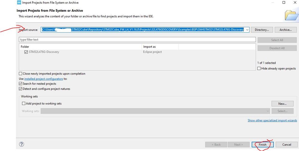

Have you got a try to import available example from STM32Cube FW pack ?
Rely on File > Open Project From File System
You will get a compile sucess project.
According Doc folder content:
2020-12-03 8:01 AM
Thanks for your response, it was really helpful. The folder imported into the software ok.Is it just a case of moving the right files to the project created to run the domonstration software?
2020-12-03 8:18 AM
Once imported. Just build it (click hammer icon if toolbar) then run it.

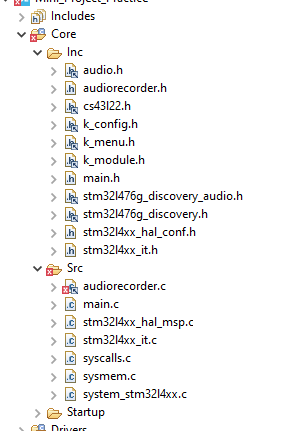

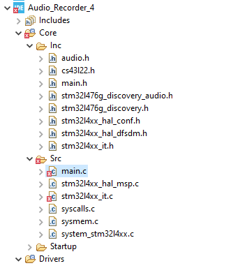

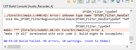

Thanks for your response it was really healpful. I have the files imported to the STM Cube software IDE with no issues.When the example software files for the audio player on the STM32L476VG DISCO controller are put in the Core, Inc and Src file directories and all the initial errors are clear after the requested header files have been added, when the project is built by hitting the hammer icon lots of errors are being picked up.
I had to delete some code from the #include"cs43l22.h" header file to allow the code to connect to the header file in the Core Inc file dirrectory. I have attached a screen shot of the original code before deleting code to make it read #include"cs43l22.h" instead of #include"../Components/cs43l22/cs43l22.h"
It may be somethis I am doing because I am very new to the STMCubeIDE. The IDE dosen't like something because it deletes code when I make changes and comes back with more errors each time the debugging application is launched. I am understanding the example software code is all ready to go and building the project is all that is required onec all the files are added to the right file dirrectory.
I have included screen shots of the files I have added. The reason there is more than the example software in the IDE is becuse they have been added to clear an error with a header file or HAL driver. Your help would be much appriciated.
