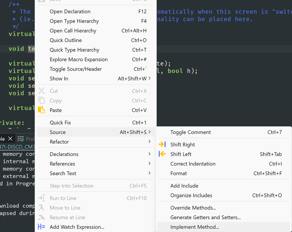

2022-06-15 1:48 AM

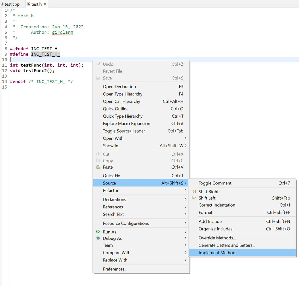

I tested it with a C++ file and nothing happens when I click on "Implement method":
Here's where I right click:
The file is saved, the source file exists and I can navigate to it by both "switch header / source" and pressing F12 (F3 with original bindings) on an already implemented method.

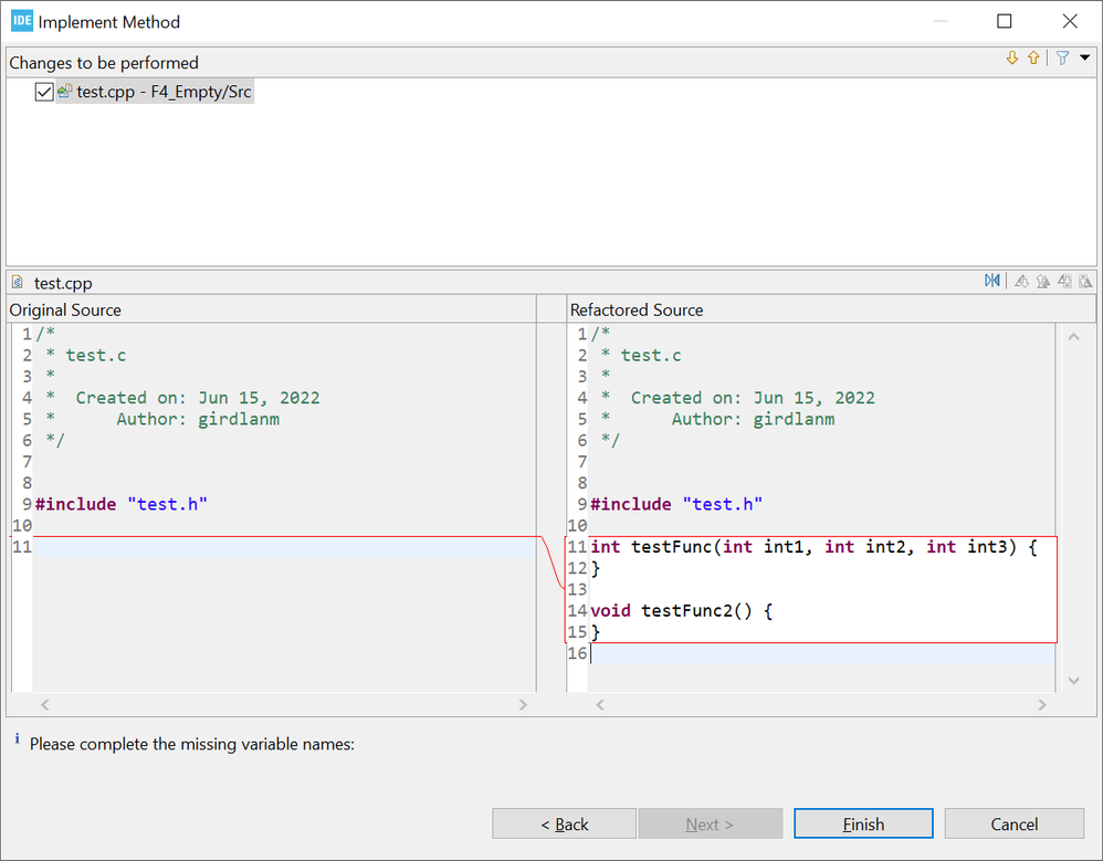

I haven't used this method before, I just ran a simple test when I read your question earlier today. Here's how I did my test:

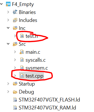

I set up an empty C++ project for an F4 discovery board and just added a "test.h" and "test.cpp". From the test.cpp I added a simple
#include "test.h"This made the project structure look like this:

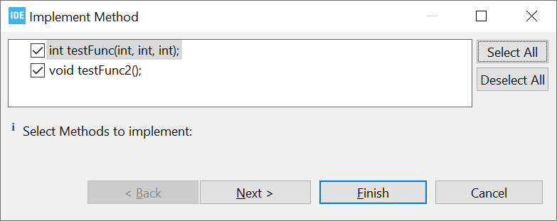

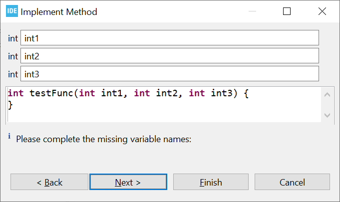

I set up two test functions in the header file:

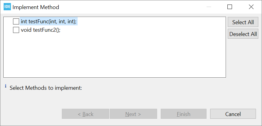

This allows me to use the Implement Method option:
This then gets added to the test.cpp:

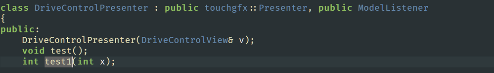

2022-06-15 2:30 AM
And here's what I got when I try to use implement shortcut I've just made on .cpp file:
While still in the .hpp file I have:

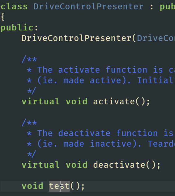

2022-06-15 2:39 AM
What's even weirder, here's .hpp part that is NOT IMPLEMENTED:
It compiles without errors or warnings.

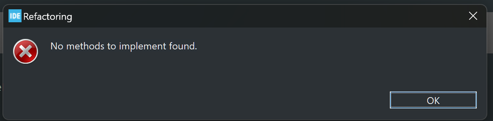

2022-06-15 3:11 AM
I tried both. In .hpp it does nothing, in C++ it shows "No methods to implement".
