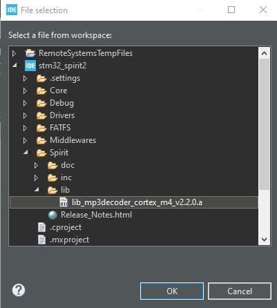

Now I am trying to add the .a file to the Libraries tab (Project -> Properties -> C/C++ General -> Paths and Symbols -> Libraries). I can find the file in the CubeIDE explorer:
It's now displayed as "${workspace_loc:/stm32_spirit2/Spirit/lib/lib_mp3decoder_cortex_m4_v2.2.0.a}" in this tab.
When I'm building the project I get the following error:
d:\programme\stm32cubeide_1.4.0\stm32cubeide\plugins\com.st.stm32cube.ide.mcu.externaltools.gnu-tools-for-stm32.7-2018-q2-update.win32_1.4.0.202007081208\tools\arm-none-eabi\bin\ld.exe: cannot find -lD:/Projekte/Tinnitus/pre/stm32_spirit2/Spirit/lib/lib_mp3decoder_cortex_m4_v2.2.0.a
Why can't the ld.exe find this file now? The CubeIDE explorer did find it...

2020-09-09 4:26 AM
I finally figured out what to do....
This took me 2 days over all...
In Project -> Properties -> C/C++ General -> Paths and Symbols -> Library Paths you have to set the path of the .a file. (Add -> Workspace -> Search for the folder an select "Is a workspace path").
Then the trick comes: In Project -> Properties -> C/C++ General -> Paths and Symbols -> Libraries you have to add the library without prefix and suffix. Prefix is "lib" and suffix is ".a". So for my library (lib_mp3decoder_cortex_m4_v2.2.0.a) it is _mp3decoder_cortex_m4_v2.2.0 that's a rule of the gcc linker. I think this is very unintuitive and you have to invest a lot of time to get that information.
