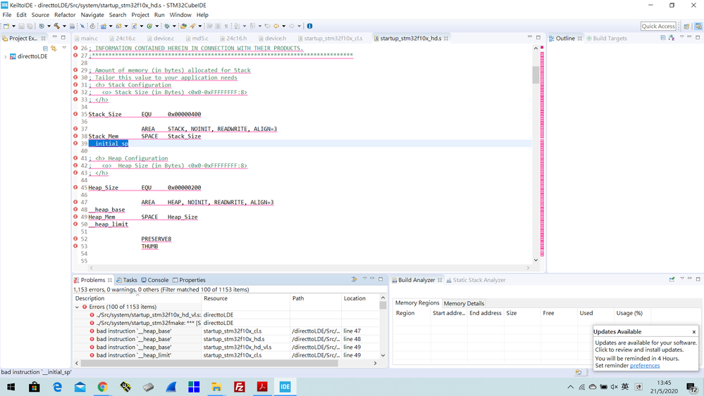

my question is as the topic stated above. My situation is that I have my completed project on Keil Vision 5 which works well, but for some reason I need to migrate the whole firmware to STM32CubeIDE.
I googled about the problem and there is no much information about it, while the only seem-valid message i got is: SPL seems not to be supported by STM32CubeIDE.
is rewriting all libraries the only way for me to complete the migration? If so, is there any hints or shortcut for me to do so? Or I really have to rewrite the whole thing?
P.S. I tried moving the files to STM32CubeIDE from Keil and the following picture shows my result
And I figured out that the way to configure GPIO is kind of different that it not quite easy to directly modify it.
I am using STM32F103RCT6
See if there is someone who can answer me so that I dont have to further waste my time to figure out how to do the migration, and rewrite the whole thing instead.

STM32CubeIDE can compile whatever code you want. It's just an IDE with some fancy features. The IDE part doesn't require you to use HAL or LL or SPL or anything. It's not going to be as easy to set up, but you can do it.
2020-05-21 6:38 AM
The C compiler should be compatible save for a few quirks, the assembler is not.
Create a new STM32 project, select your MCU, and choose empty project at the final dialog of the project wizard. A handful of C sources files will be created, move them out of the way. Keep the startup*.s and STM32*_FLASH.ld files.
Then you can drop your existing C source files (*.c and *.h only) into the project directory. Right-click on the project root, select Refresh then Index - Rebuild. Set the include paths in the Project - Properties - C/C++ Build - Settings - [ All configurations ] - Tool settings - MCU GCC Compiler - Include paths tab.
If there are still problems, look for compiler-specific constructs in your code, and replace them with their gcc equivalents.

I am kind of a beginner and have never heard of gcc. I will give it a shot definitely.
