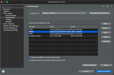

1) Go on Project-> Properties and change add the folder where compiledb is installed in PATH as shown below.

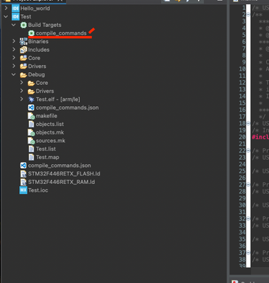

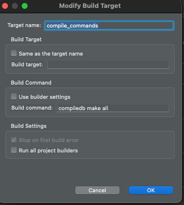

2) Go to Project -> Build Targets -> Create... Uncheck all the options and add the custom command you need for creating the compile_commands.json file in the Build commands.
3) Select the newly created target on the left hand side of CubeIDE, right click and select Build Target.
4) Once your compile_commands.json is created, you have to move it in the upper folder (root of your project).

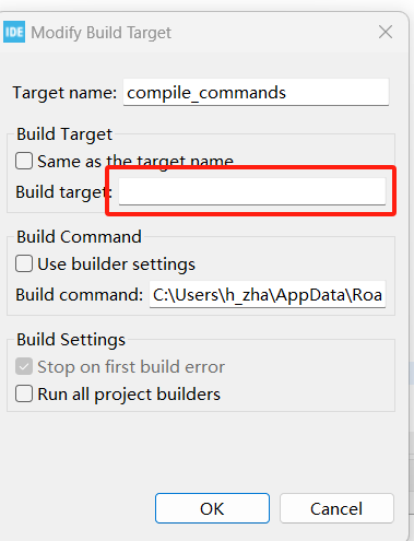

2024-11-21 8:45 PM
You must set "Build taget" empty !!!

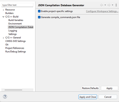

2025-08-18 12:34 AM
I am using STM32CubeIDE version 1.19.0 and I have right clicked my project, gone to properties, C/C++ Build, JSON Compiliation Database Generator. ticked the 2 boxes and away it went.
