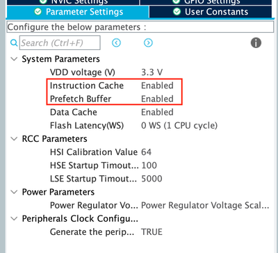

But when using ONLY LL library, these two settings are ignored. Enabling or disabling the two settings generates the same code. Please fix it.

I am using STM32G03x. As I said earlier, to test this, please do NOT use any HAL components, just use only Low Level library. So stm32xx_hal_conf.h is not generated and there is no such file in the STM32Cube project.
When you change Prefetch Buffer and Instruction Cache in the above screen. Their values are updated in .project and .mxproject. But there is no initialization codes to use the values. So these settings are always power on default values.
If you use any HAL library, HAL_Init will be generated and there are initialization codes (in my first post) for these settings.
So using pure Low Level library, the Prefetch Buffer and Instruction Cache initialization codes are missing. The missing part is listed below. Code generation should add these code to main() if HAL is not used.

I have found the same problem configuring a STM32F405 project using the low level interface only.
Regardless of the settings of 'Instruction cache'/'Data cache'/'Prefetch buffer' no code is generated to apply these settings.
As a drawback the ADC is not working as expected.
I kindly ask to fix this bug. Even after 15+ years of working with the STM32 family it was hard to figure out the reason why a peripheral is not working as specified if these settings are not done properly.
