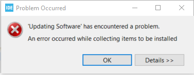

2024-05-10 11:19 PM
I tried to install sonarlint 10.1 on STM32cubeIDE 1.7.0 on Windows using eclipse marketplace as well as using offline .zip file.
In both cases I am getting error for installing dependencies.
it allows to install sonarlint v5.0 and below without any issue.
