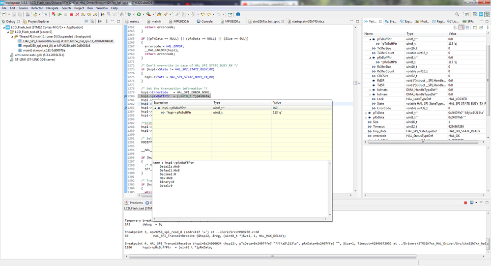

}Got some debug results:
The receive buffer contains the correct data but the result is zero, looks like an error in the TransmissionReceive method?
