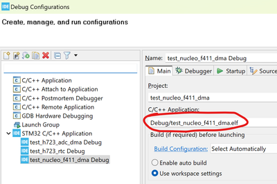

Change it in the Debug or Run Configuration tab.

Please review the project settings for the build artifact(s) and ensure that all slashes are / not \, this will work even on Windows. Eclipse on Windows will take care to substitute these slashes, but it cannot always guess for the opposite direction. If you are brave, open .cproject and .launch files in a text editor and replace all backslashes there.
2025-04-11 2:39 AM
Thanks, that worked, the error is gone.
