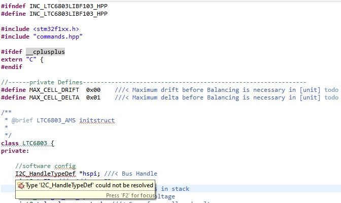

This is what it looks like in editor
never mind me trying to initialize spi as i2c, fixed it, but that's not the problem.
2021-08-01 7:43 AM
Got it, I had to make the changes suggested by TDK, and then first refresh, then rebuild the index.
