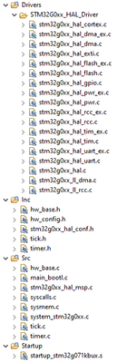

I need to create two projects, under a common root, that shares user files and HAL drivers.
The project tree look like this:
\Inc
\Src
\Startup
\Drivers
\Project1
\Project2
So I started to create an empty STM32 project.
Then I have added the necessary preprocessor symbols and include path to include HAL drivers in my project.
As I want to include the HAL drivers files as a reference, I linked the Driver folder to my project using the feature "Link to files and recreate folder structures with virtual folders".

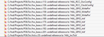

However, when building I have undefined reference errors to HAL functions.
It is not an include path problems, but it seems like the HAL source files aren't added to the project.

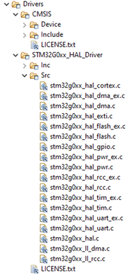

at least I found a solution creating the folder structure using File->New->Source/Source folder menù options, and then adding the files, using the "Link to files" option.
So this issue is no more blocking for me.
Anyway, if I try to add the entire /Drivers folder using the “Link to files and recreate folder structure with virtual folders” option, I have the following mistakes.
I also tried to use the “Link to files and folders” instead of “Link to files and recreate folder structure with virtual folders”, but even in this case I wasn’t able to compile.
