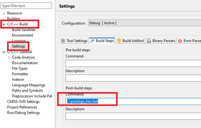

Basically this is how the command works: srec_cat.exe FIRST_HEX.hex -Intel SECOND_HEX.hex -Intel -o OUTPUT_HEX.hex -Intel
You need to install SRecord utility (in the attachement) and follow the same procedure provided by GHolc.1 in https://community.st.com/t5/stm32-mcus-boards-and-hardware/production-flash-tool-for-dual-core-stm32h745/m-p/640740 to create .bat file and call it in Post-Build as shown here:
I didn't test the procedure. If It doesn't work, please contact your local FAE as you have a high-volume project.

I am currently using STM32Cube IDE. I'm not sure if it will work the same as KEil. Additionally, the file does not download from the link.

srec_cat.exe is not related to keil.
Refer to its documentation: https://srecord.sourceforge.net/man/man1/srec_cat.1.html

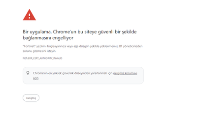

Google does not find the site safe. I removed all firewalls but it still refuses to download. There was another way to download it. Any chance of sharing via email or github?
