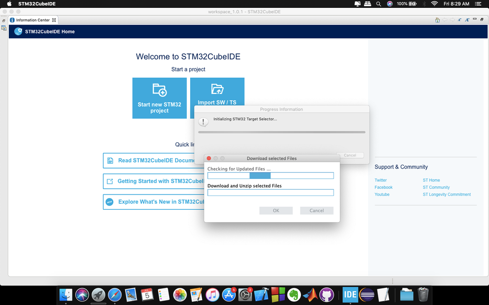

Hello, maybe you have an issue with the proxy.
Check on STM32IDE settings if proxy parameter are aligned with your policy network.
Regards
2019-07-04 11:20 PM
Regards
2019-07-04 11:25 PM
Thanks for the quick response. Could you please guide me with the steps to align the proxy parameters?
2019-07-04 11:39 PM
Please, are you on a public, private or business ... network?
2019-07-04 11:40 PM
Private network
2019-07-04 11:49 PM
In STM32CubeIDE go in "Windows" menu--> Preferences--> general--> Network Connections.
If you have specific settings for your network, it's the place to be ;) .
If you are not able to connect to the net, you can disable the automatic update in "Windows" menu--> Preferences-->"Install/Update" menu!
