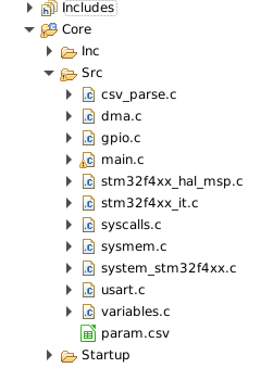

The source folder is for source files: the files used by the compiler to generate code or data. Your CVS file is not a source file recognized by the compiler.
You must add a "disk" manager to your application (look at FATFS) and a memory support (SD card ?)

How's the code running on the F407-DISCO going to fopen() a file on the host PC? Do you have ANY file system or STDIO implementation on the target board?
