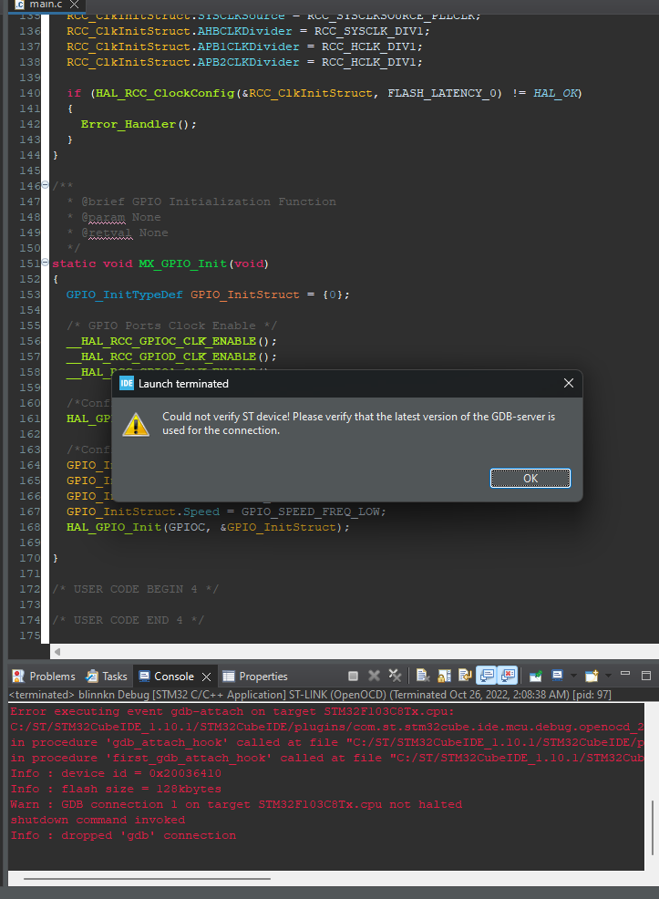

Has it worked before?
Is this a Blue Pill board with a fake STM32?
What's connected to the probe? You have NRST? Does connect under reset work?
Does STM32 Cube Programmer, the stand-alone app, work with this board/part?

Duplicate thread https://community.st.com/s/question/0D53W00001tMmEDSA0/can-anyone-help-me-solve-the-failed-to-start-gdb-server-error
2022-10-27 5:39 AM
Yes - seems like duplicate post. Difference is that here it is OpenOCD which is reporting fake device. In the other thread it is ST-LINK GDB server...
Based on the discussion in the previous thread I think we can "close" this one too...

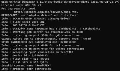

AOA Ahmed, I am facing a similar issue with STM32F407. My OpenOCD (gdb-server) is running remotely on Raspberry pi. Until STMCube IDE version 1.6 everything was fine. I updated it today to version 1.14 and it started giving this error. I have seen most of the posts in the context of bluepill. On OpenOCD side, i have these messages:
Can you please tell me how did you solve it?
