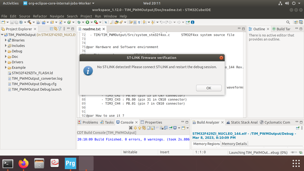

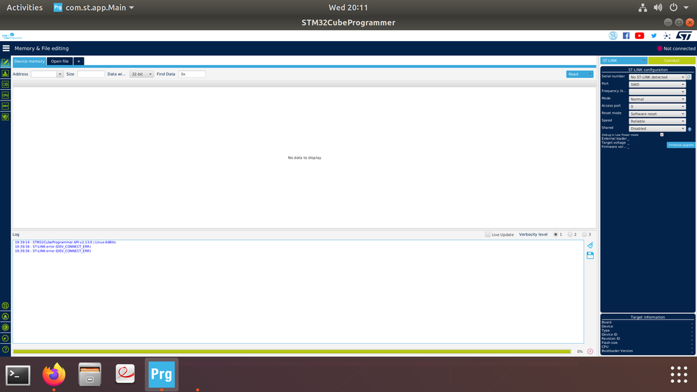

I just waited a while, and opened the IDE again, it prompted me to upgrade the FW of st-link, I updated it and restarted machine, then it were OK - the board could be detected in both IDE and Prog.
