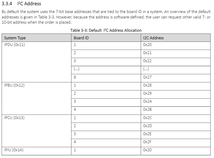

Device's table of addresses:

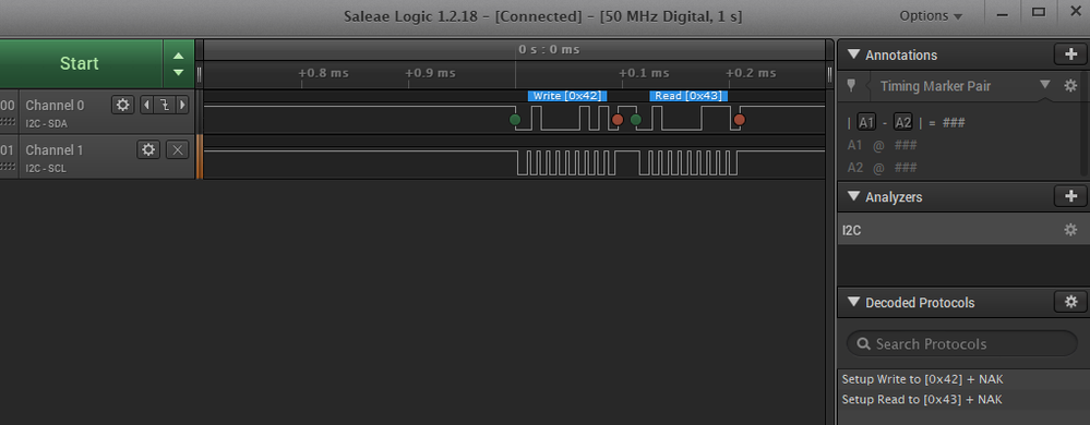

0693W000008zKkNQAU.pngAttempt to send to address 0x42:

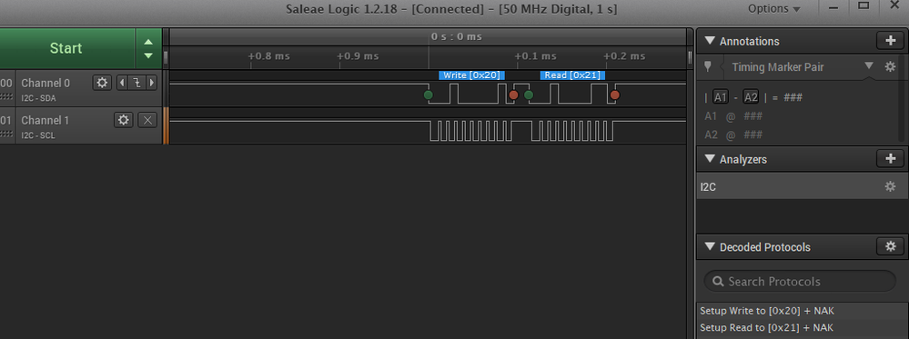

0693W000008zKkXQAU.pngAttempt to send to address 0x20:
It says that these are 7-bit addresses and the doxygen header to HAL_I2C_Master_Transmit says that 7-bit addresses have to be left-shifted, so you have to use 0x21<<1 as parameter, which your LA incorrectly displays as 0x42 (many LA do so).
However, that table does not indicate that you have a *range* of addresses available from which you can pick one at will. Rather, it indicates that the device has one unique address, determined at its manufacturing time.
