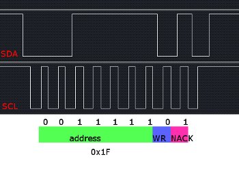

I've been working with ST HAL libraries for an STM32F030R8T6, using the NUCLEO board, and I'm having some problems with the I2C API. Probably it's a configuration issue but for the love of me, I can't find it. The problem: I call the functionHAL_I2C_Master_Transmit_XX
with address 0x3E. I attach a logic analyzer to the output to check the lines, and the address does not match. The address I see on the line is 0x1F. My main test code is the following. (Just to reproduce this situation) It is a direct copy from the NUCLEO examples. I skip over theSystemClock_Config

This code, when examining the output with the logic analyzer, generates the following SDA/SCL sequence.

I understand that on 7 bit address mode, the CR2 bits used to generate the address are SADD[7:1] neglecting the value of SADD0. But the ST HAL driver seems to write the value directly (with no shifting at all),
hence the ''transformation'' from 0x3E to 0x1F:
I2C_CR2[7:0] = 0x3E
I2C_CR2[7:1] = 0x1F
This would be fine for 10 bit addresses, but I'm having trouble with 7 bit.
I tested using an I2C temperature sensor (address 0x40). And I can't read anything at all using 0x40, but everything is fine and dandy when using 0x
Could somebody please point me to any configuration flag that I may have missed?

ST, like many others, represent the 7-bit address as the high order 7-bits exactly as they appear on the bus, and the low order R/W bit is determined depending on the nature of the interaction. In these types of systems the address becomes (DATASHEET_ADDR << 1)
2016-02-15 1:00 AM
Thanks for your response.
I was already shifting the address, but was not sure if this was the ''correct'' behaviour. Salut!2016-02-15 2:20 AM
No problem, you just have to watch the system and device data sheets and implementations very carefully. People have represented the 7-bit address in all manner of ways over the decades, so I always double check what the data sheet says, and what the timing diagram illustrates, and then contrast that with how it is handled in the software side driver stack.
