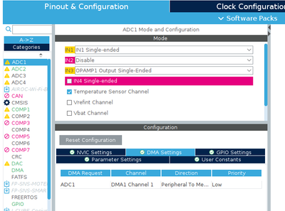

This is just the info/error : DMA impossible, because you didnt activate any peripherals to work with the DMA.
ie:
Select anything you want to work with DMA : SPI , ADC, I2S ... , set it to the mode you want, then you can add a DMA channel there.
ADC example:
