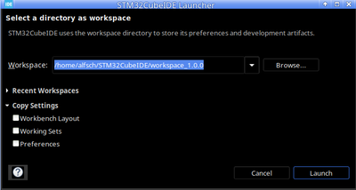

Did you try : switch workspace + copy the settings , you want to have -> layout...etc. ?
Then try : make new stm32-project (there now) , generate code and debug... works ?
