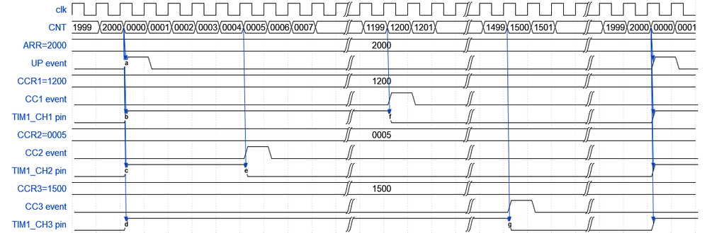

2024-02-21 10:30 AM
There is only one counter per timer, so you can't generate several different PWM frequencies with one timer. What changing of compare register does is only the pulse width.
Read the timer chapter in Reference Manual.

2024-02-22 12:56 AM - edited 2024-02-22 1:01 AM
Maybe the following diagram helps you. There's only one counter (CNT), and so all PWMs (TIMx_CHx outputs) have the same frequency given by value in TIMx_ARR; they differ only in the duty cycle (pulse width), set in TIMx_CCRx:
(Drawn with https://wavedrom.com/editor.html ).
2024-02-22 4:39 AM
I understand your point, thank you. However, in my code whenever a counter values reaches to CCR1 value, then interrupt is called in which CCR1 value is updated, so that another match is aimed. This will allow to obtain signals with different frequencies that is that is generated by Timer4.
Also about your diagram, why TIMx_CHx starts with high when up event occured ? In fact, why TIMx_CHx is toggled when counter reaches to threshold and up event occurs. This is not a case which CCRx and CNT values matches.

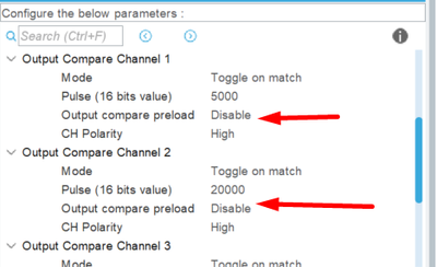

2024-02-22 6:42 AM
Thank you @waclawek.jan all good now.
One point left open for me that is, what is the impact of Output Compare Preload field exactly?
When I enabled it, timer couldnt generate the expected signals.
2024-02-24 1:53 PM
If Preload is enabled, the value you write into TIMx_CCRx is not used immediately, but only after an Update (i.e. timer overflow) happens.
