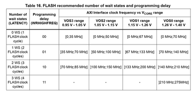

i just can show you my setup - its on H743 (480 M max.), so almost same.
BUT scale 2 -> 275 M core + 0 WS waitstates -> cannot work. Just wrong. Cube silly here or -- i dont know.
I have IDE 1.13.1 running , on Laptop 1.14.1 . I didnt try V 1.15.x , because many report problems after update.
IF this is an error in Cube, try setting my setup , also the WS .
see flash/wait for H723 :
If i read this, i'd say: you need 2 WS at 275MHz core . (same as on my H743 )

CUBEIDE doesn't let me modify the FLASH-WaitState, there is an asterix, poinnting to the statement "the setting is adjusted automatically when the Voltage-scale is set" (or something similar). I'm amazed about the relation, by trial and error I found the following relation:
- Volt scale 0 3WS (4 CPU cycles)
- Volt scale 1 0WS (1 CPU cycle)
- Volt scale 2 0WS (1 CPU cycle)
- Volt scale 3 0WS (1 CPU cycle)
I tried a debug session with Volt scale 1: the previous error showed up again. Then, with setting 'Volt scale 0' => 3WS my problem looks to be solved. I got another error, now something with SPI, but not the repeating line 1139 of file 'stm32h7xx_hal_rcc.c' !
