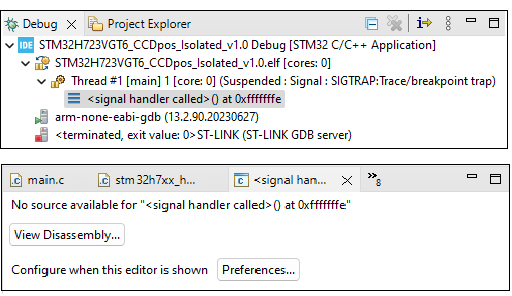

With trial and error I determined the exact statement that produces the error. The picture below shows the 'Debug' window and the window with the 'Disassembly' control.
The content of the 'Disassembly output' is shown here:

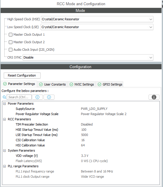

CUBEIDE doesn't let me modify the FLASH-WaitState, there is an asterix, poinnting to the statement "the setting is adjusted automatically when the Voltage-scale is set" (or something similar). I'm amazed about the relation, by trial and error I found the following relation:
- Volt scale 0 3WS (4 CPU cycles)
- Volt scale 1 0WS (1 CPU cycle)
- Volt scale 2 0WS (1 CPU cycle)
- Volt scale 3 0WS (1 CPU cycle)
I tried a debug session with Volt scale 1: the previous error showed up again. Then, with setting 'Volt scale 0' => 3WS my problem looks to be solved. I got another error, now something with SPI, but not the repeating line 1139 of file 'stm32h7xx_hal_rcc.c' !

I did a debug "step-in", which brought the debugger in an undefined state: not 'running' but also the buttons for 'stepping' were greyed-out. Then I pushed on the button 'Suspend', and got in the well-known state where 'Disassembly' shows:
fffffffe: Failed to execute MI command:
-data-disassemble -s 4294967294 -e 4294967470 -- 2
Error message from debugger back end:
Cannot access memory at address 0xfffffffe
BTW: already before executing your proposed test, I uncoupled the WeAct board from the rest of my test-setup to eliminate possible influences from my HW. So, both the original project with my code included and the "stripped" project show the same error.

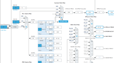

1. why set so "uneven" clocks ? see my setting for 200M +48 for usb:
2. why your pll multipier not shown ? see my pic.

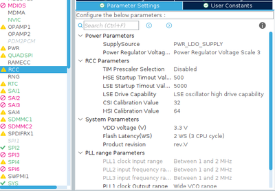

3. check, what cube set for flash delay + core range settings:

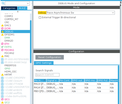

did you enable debug ?

About the Clock settings: 1) the MCU is capable to run @ 550MHz, but the Clock Configuration panel showed 275MHz as maximum, so I changed my setting accordingly. It surprises me your picture shows other maxima than I see in my CUBEIDE. 2) The PLL-multiplier values are not shown because the value (x129) doesn't fit in its field (1 step magnification solves this).
About Voltage settings: 3) I did not change any value, so my project uses the defaults. Here also the window is a bit different, possibly another MCU. My window shows:
About Debug: 4) You are right, I didn't configure the debug feature, I was not familiar with the new layout where Debug is a separate item. Despite that, I could run the debugger before switching it <on>. After switching the result was identical, error @ line 1139 of file 'stm32h7xx_hal_rcc.c'.
