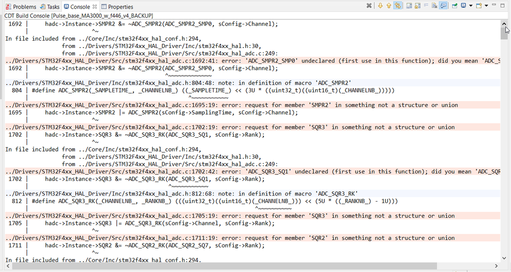

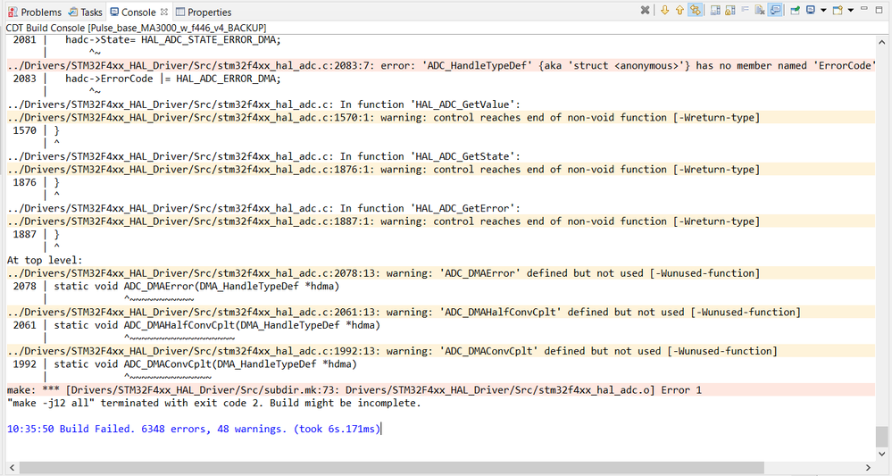

I have a project in stm32cubeide that I have been using and updating for a while and have not had any issues. Now however, I get
10:35:50 Build Failed. 6348 errors, 48 warnings. (took 6s.171ms)

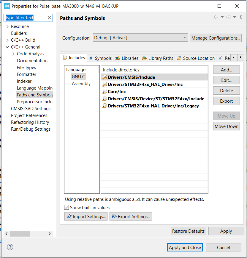

Looking at some of the errors, it ranges from undeclared variables, to not recognising number formats. It looks like a driver or path issue but the paths look OK to me. Cleaning the the project and rebuilding does nothing. Here is a screenshot of some of the errors and the path:
Any suggestions as to what I could try next would be appreciated.

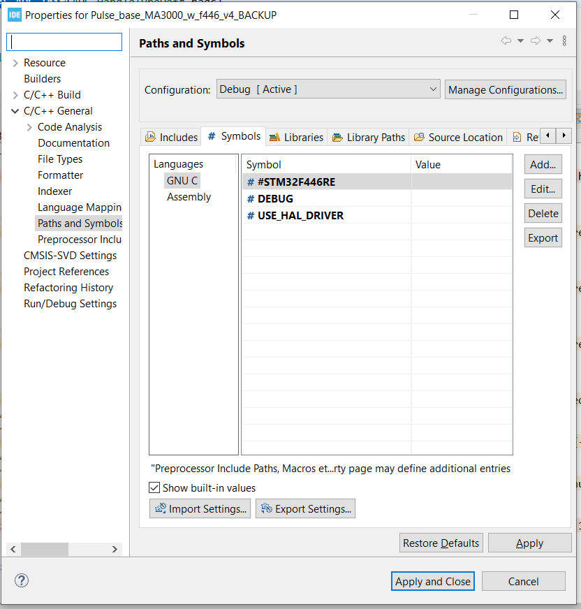

In your path there is STM32F767 but the screenshots shows STM32F446...
In the 1st screenshot there is #STM32F446RE., Try STM32F446xx
Without # and without RE

Take care that the project root folder is on a short simple path, not containing spaces, non-ASCII chars or other difficulties.
hth
KnarfB
HI, thanks for the suggestion but the project root is the same as it has always been (and it has been working until recently - no idea what has changed overnight). It is a
D:\Engineering_Software\STMicroelectronics\STM32F767\Pulse_base_MA3000_w_f446_v4_BACKUP
I knew it was going to be something simple. Good eye, it was indeed an incorrect symbol. Thanks!
