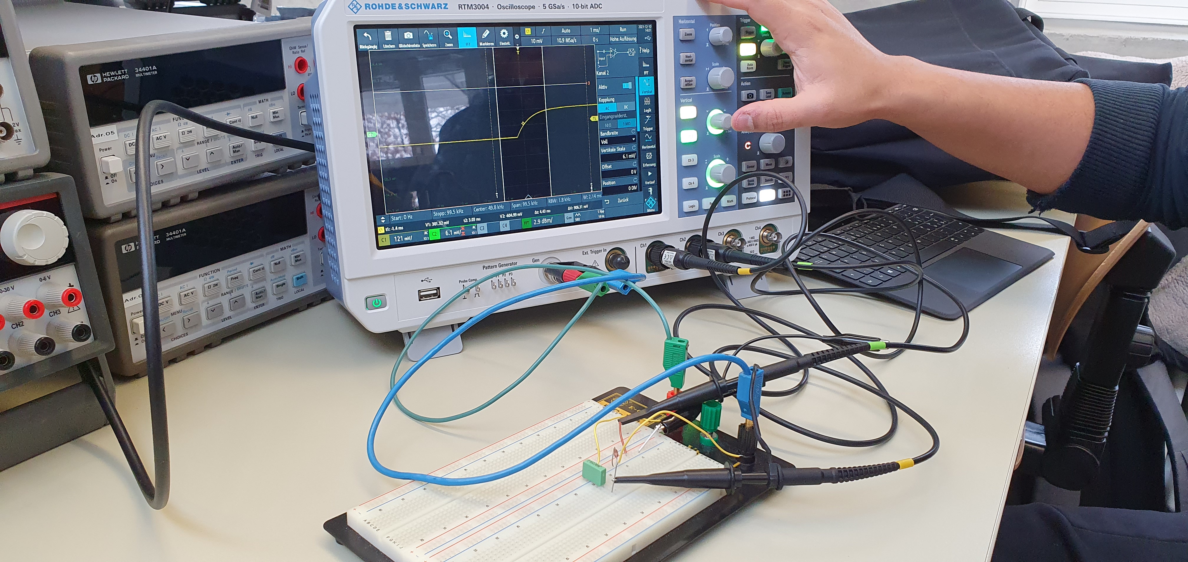

Now a little update on my problem.
I have now put the USB and HSI48 problem aside and after a while I noticed that probably the power supply really causes the problem. If I use too many GPIO's (at high speed), the MCU also says goodbye (at 8MHz clock).
My power supply is designed as follows:
12V are available as source and with a step-down converter (TPS562231DRLR) 5.1V is generated. Afterwards I use a linear regulator to generate the 3.3V (AP7380-33Y-13). This can supply 150mA...obviously not enough for 48MHz. In the datasheet (table 29 and 30) I found a value of a little less than 30mA with HSI48 switched on. But that would contradict my opinion again.
In summary I can say: As soon as I am back in the workshop, I will feed the MCU with a powerful 3.3V power supply and measure the current. I will post the results here.
PS: The power supply via the ST-Link is a very bad idea. After I turned on some more outputs and used an i2c port, the ST-Link could not hold the voltage level of 3.3V. Via the external power supply everything went fine.

I've been suggesting it's likely a power issue since post 1. But if it was a power issue, you should have seen VDD dropping on the scope.
Touby
Associate II
That's true, of course, but I also thought it was an incorrect measurement on my part.
I could now test it in the lab and got the same result again (with my pricey lab power supply) . As soon as the CR2 register is written (any bits), the microcontroller goes into reset mode. So I checked the addressing of the CR2 register in the CMSIS files. The RCC register is addressed with 0x40021000, so it is correct according to the reference manual. The offset of the CR2 register is 0x34 according to the reference manual. If I now press the macro CR2 via the above described ways to get to the definition (finally in the stm32f072xb.h file), I am shown 5 different options how the CR2 offset is defined. I didn't quite figure it out in the corresponding file.
Therefore I tried the direct way:
#define reg_32 *(( volatile unsigned long *) 0x40021034 )
reg_32 |= 0x10000;
Even with this I can't write to the CR2 register (I hope the direct addressing is correct, I haven't done it for a while). Now I have no idea, except to put an external oscillator on the board or to throw this microcontroller in the garbage can and try another USB capable microcontroller.
