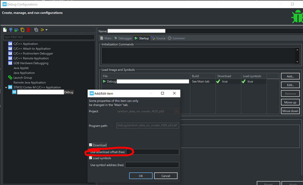

2021-11-22 7:34 AM
There is a download offset you can specify within the run/debug configuration. It's going to be a lot more straightforward to stick with ELF or HEX files for this application.
