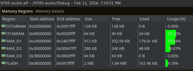

I use ITC for stack and heap, D2 for circular DMA (always running), D1 for all other:

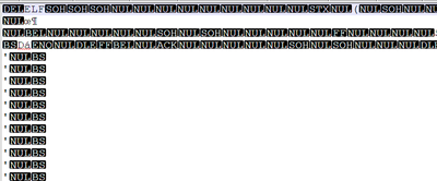

I tried looking in the ELF file, and I only observe below. I even tried searching with RAM_D1 but the search did not produce any result. Am I missing something in settings due to which I do not observe information similar to the snippet that you have shared?

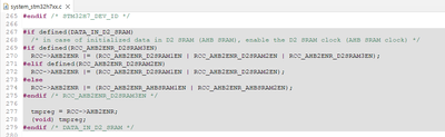

Below is the snippet from the system_stm32h7xx.c file. The code part has a greyed background which means that the code part is disabled.
This means that even line number 270 is disabled (which is the code line that you have shared in your response).
Now if I try finding the macro (DATA_IN_D2_SRAM) used on line number 267 the macro is commented out.
Thus I am unable to understand which part of code (generated by STM32CubeMX and being compiled using STM32CubeIDE) is enabling the clocks to the RAM_D2 and RAM_D3 sections.

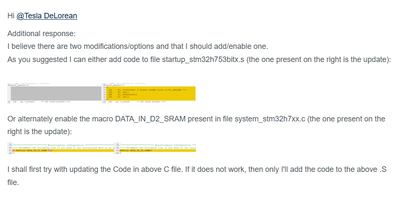

I believe there are two modifications/options and that I should add/enable one.
As you suggested I can either add code to file startup_stm32h753bitx.s (the one present on the right is the update):
Or alternately enable the macro DATA_IN_D2_SRAM present in file system_stm32h7xx.c (the one present on the right is the update):
I shall first try with updating the Code in above C file. If it does not work, then only I'll add the code to the above .S file.
