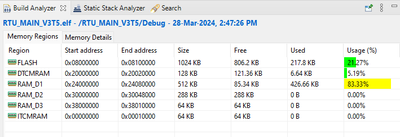

Hi All,
I want to use DTCRAM in stm32cubeide, the controller i used is stm32h743, earlier I
Used RAM_D2. shifting from RAM_D2 to DTCRAM is possible but both i cant use,
please guide me,
/DISCARD/ :
libc.a ( * )
libm.a ( * )
libgcc.a ( * )
.RAMD2buffers(NOLOAD) : {
. = ALIGN(4);
*(.buffers*)
} > DTCMRAM
.bssDTCMRAM(NOLOAD) : {
. = ALIGN(4);
*(.buffersDT*)
} > RAM_D2
.ARM.attributes 0 : { *(.ARM.attributes) }the above code is added to linker file,
//__attribute__ ((section(".buffers"), used))
char rData[BUF_SIZE];// Read data
uint32_t DMA_ADC1[ADC1_Size];
uint32_t DMA_ADC2[ADC2_Size];
uint32_t DMA_ADC3[ADC3_Size];
__attribute__ ((section(".buffersDT")))
uint32_t DMA_ADC3_dummy[ADC3_Size];
this code added to main file,
thanking you

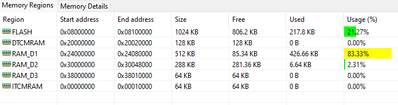

. = ALIGN(4);
*(.buffers*)
} > DTCMRAM
. = ALIGN(4);
*(.buffersDT*)
} > RAM_D2In above OP, this works
the memory located in DTCRAM for " buffers" only. but what about bufferDT, Tha aRAM_D2 showing noting. If I Invert the DTCMRAM And RAM_D2 as shown in below

From above. I can say that only first section get into account by compiler and second one discarded.
please guide me.
thanking you
2024-03-29 2:32 AM - edited 2024-03-29 2:33 AM
Pattern *(.buffers*) is before *(.buffersDT*) in the script, so it captures the latter. Move the 2nd section up above the 1st one.
