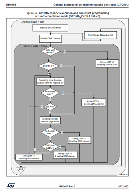

There will be no issue in your case since the modification is performed before enabling the DMA (GPDMA_CxCR.EN=1 by calling HAL_DMAEx_List_Start ). We can't neither consider that the reconfiguration you did is dynamic for the same reason (DMA still not started).
Dynamic reconfiguration of DMA is possible in STM32U5 (see figure below from RM0456) when the DMA Enable bit is dis-asserted (GPDMA_CxCR.EN=0). This bit is automatically disasserted after transfer complete or transfer error, so that reconfiguration can be done after each transfer.
