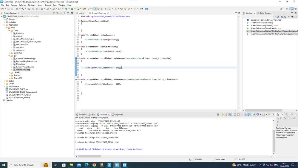

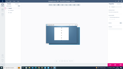

I have referred to the Scroll Wheel TouchGFX Documentation. My values changing negative to positive values. But I need positive values with higher numbers comes from the above.
(like.....60, 40, 20, 0, -20, -40, -60......) How to do that?
Next, I want to roll the digits according to the user change in both the simulation and Board...How? What are the changes should be done in the code so that the digit will be displayed in the simulation and the Board according to the user input.

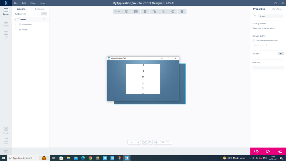

Hii,
I have seen the simulated version that you have attached. But I need positive values should be displayed before zero as I already mentioned...Anyway I have done it. All I need is how can I display a 5-digit value from the three different scroll Lists i.e. the one's and ten's place of the digit should be in scrollList1, and the hundred's place is in scrollList2, and the thousand's and ten thousand's place is in scrollList3.
Could you please share your Touchgfx gui and generated files of the attached simulator version.
And I didn't tried this again because of some other important work in past days. so, I didn't get much progress on this...:grinning_face_with_sweat:
Thank you...

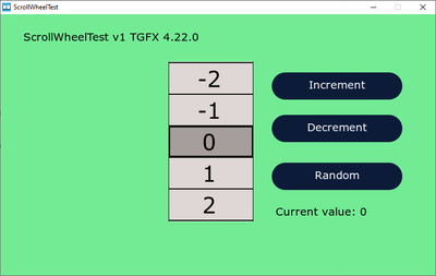

2024-03-04 8:33 AM
Hello @Shivani
I attach the complete project. Actually I have use ScrollWheel instead of ScrollList because I think it suits better to this use.
This example has also feature to send keyboard commands in TGFX simulator to screen (FrontendApplication -> model -> presenter -> Screen).
Br JTP
