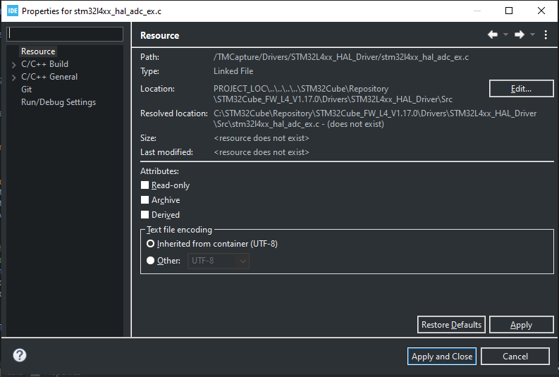

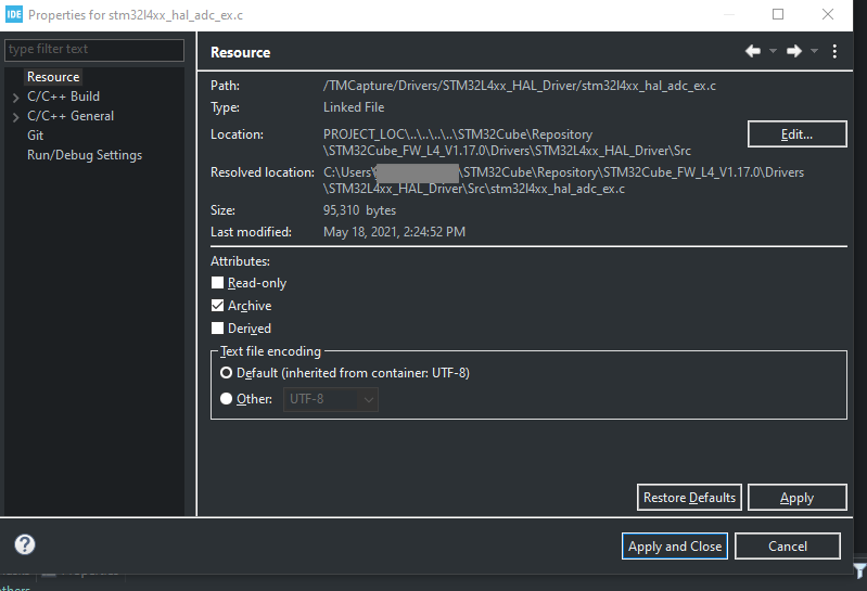

If I look at one of the files on the original (working) project I can see how it resolves:
Once I've moved the folder it resolves different and completely changes the pathing:
In practice will want to push and then clone these projects. However, each attempt ends the same way. The pathing resolves differently than where it was generated.

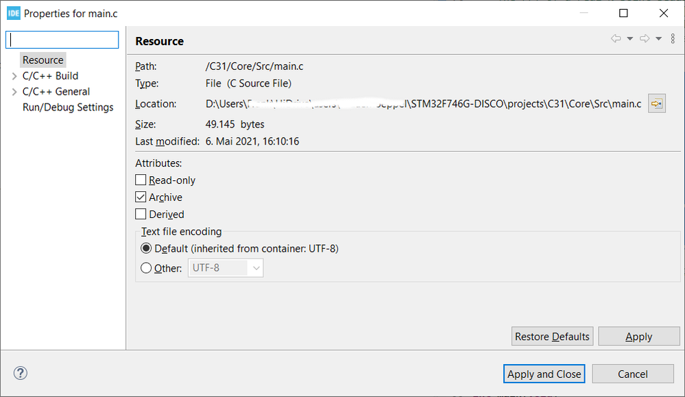

The location vs. Resolved Location looks strange to me. I use git regularily without issues. In my case, each project folder gets its own git repo. The Ressource tab looks like

The image above is a specific file in the "Drivers" subfolder, which is not part of the project. It's linked back to the STM32Cube folder where the firmware and driver code it. The issue I am having is with that type of file, not one that's physically present in the folder.
