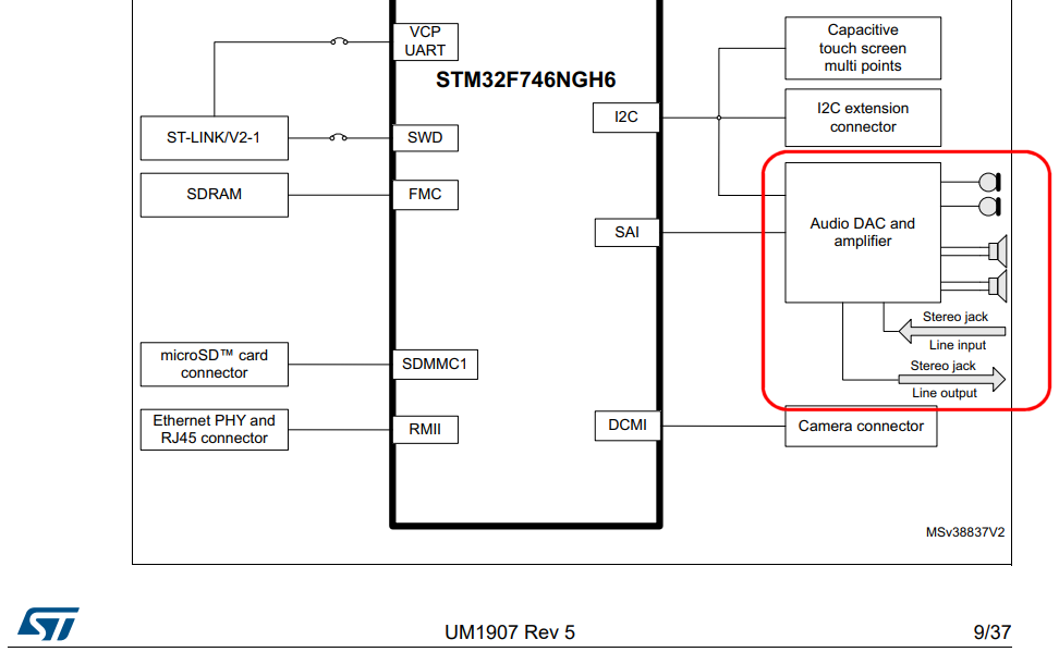

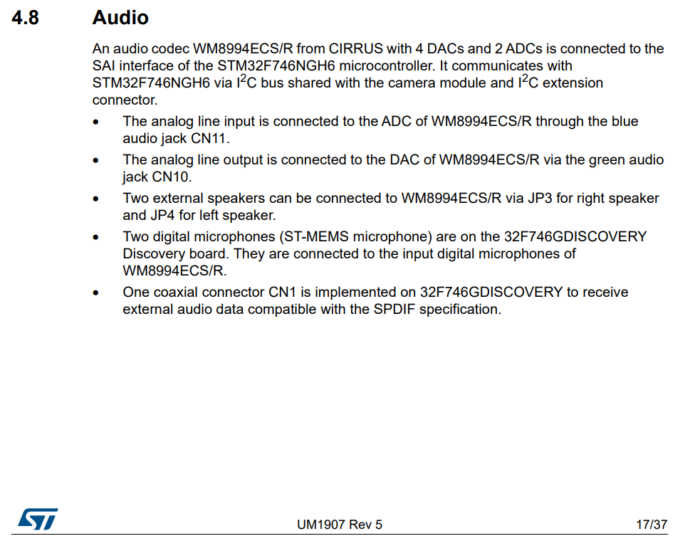

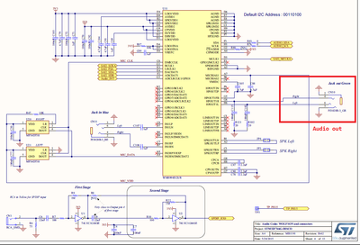

@Nhyrane wrote:
It has stereo output (two jacks).
So, from the User Manual, you'll know that they are connected to the external Audio DAC & Amplifier:
