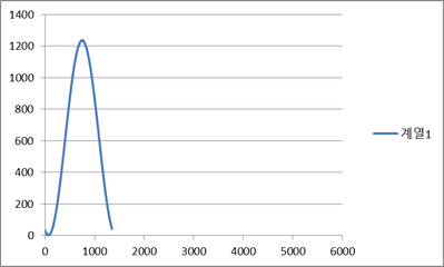

I generated a sine wave of 250Hz and advertised it, but as calculated, I had to get 8000 samples per cycle, but I only got about 1300.
Is there a reason for this?
Below is actually a waveform drawn with Excel by acquiring a cycle sample.

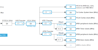

The output sine waveform is 250Hz as it is, and how many samples should be produced at this time?
My calculation is (12+3) / 84MHz = 22400, But if you sample one cycle, there are about 13,000.
DMA is not in use and operates in polling mode.

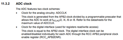

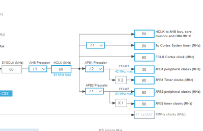

ADCCLK is shown in the Datasheet like this.
If I set APB2 to 60Mhz and clock divide to 2, is it correct that ADC operates at 30MHz?
2024-08-21 5:40 AM
So that's your problem. The chip takes time to run code, don't expect to get 5.6 Msps in polling mode.
