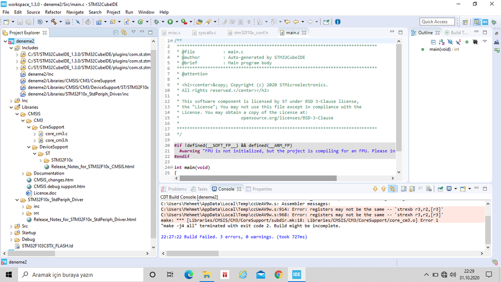

I am trying to open new project for F103C8 with SPL ( starting with empty project )
I squeezed errors down as to the following picture
how can I go further ? thank you

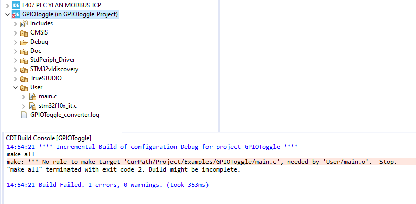

2020-11-06 4:51 AM
hello thank you
I did just like what you suggested - I clicked the project file(GPIO_Toggle_Project of VLDiscovery board) and CubeIDE opened the project
however when I tried to build it gives following error - any advice thanks

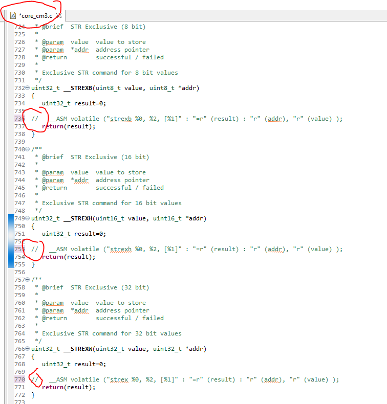

Definitively not SPL expert.
Your compilation issue is related to following lines. Commenting them is solving trouble.
But such code may be useful ... so maybe so help here: http://www.cesareriva.com/fix-registers-may-not-be-the-same-error/
SPL proposal is really deprecated one ... no more support on.
