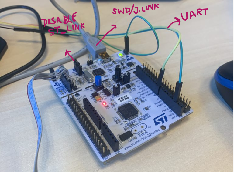

I also have a same problem. I am using STMF072RB Nucleo dev board and I am unable to get the USB HID Enumeration up and running. Did you get any solutions for this ?
0693W000005ActnQAC.pngSo over J_Link, it doesn't show up as a HID.
I think we need to take out the D+ and D- Lines and connect it to a USB Type A plug and then connect that plug to PC and then it should work! That's the guess !
Do you know if that works ?
