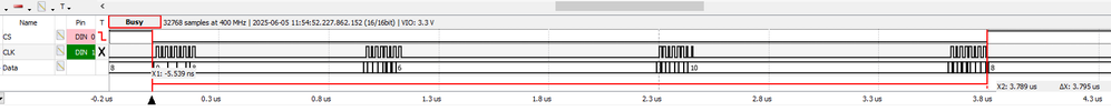

I returned to this strange problem with delays in QSPI transmission. I succeeded to enable the I and D cache in my project - it was a problem with TCP+: https://forums.freertos.org/t/freertos-tcp-stm32h743-dcache-doesnt-work/23167/10
But this do not help with QSPI. Even more - I tried to send as a data 12 bytes. Result is next:
I see that data is transmitted by 4-bytes chunks separated by similar delays as a Command. And this strange behaviour do not depend on hqspi.Init.FifoThreshold value - it can be 1 or 4 doesn't matter. All transmission takes 3.8 mks instead of 0.57 mks - this is awful!
Any idea what I can do?
