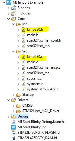

I must be very stupid. I've copied a working project, then copied the two files into the new project. Compiling fails for a number of reasons but mainly due to the #include "stm32f0xx_hal.h" in the bmp280.h file, which is clearly irrelevant.
I can't find how to re-generate code.
Your chip has a "stm32l4xx.h" file instead that you should include. You're going to run into issues when porting code. Just need to tackle them one at a time.
