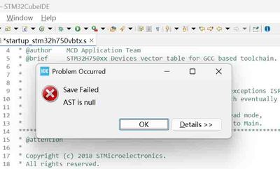

How to import assembly files and compile them in STM32CudeIDE ?
When I create a .s source file in a project, I cannot even save the file, and STM32CudeIDE only reports an error:
Save failed
AST is empty

Yes, I can. If I edit and input the C code into the new file, it will work properly. However, when entering ASM code, an error will be reported.
I tried to modify startup_stm32h750vbtx.s in the Startup folder for testing purposes, and then saved it, but the same error occurred.
I speculate that STM32CudeIDE treats the. s assembly file as C code and attempts to establish a syntax tree to provide editing assistance This may be a bug in STM32CudeIDE.

"AST is null" is from Eclipse
