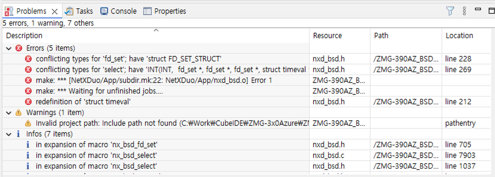

2025-05-13 11:55 PM - edited 2025-05-14 12:40 AM
Hello, robmilne.
I reached same error such as you.
Description Resource Path Location Type
expected ':', ',', ';', '}' or '__attribute__' before 'ULONG' tx_api.h /ZMG-390AZ_BSD/Middlewares/ST/threadx/common/inc line 630 C/C++ ProblemSo, I modified definition below. (with ';' semicolon end of the line)
#define TX_THREAD_EXTENSION_3 int bsd_errno;but, I reached error message below
I'm getting errors redefining libraries and definitions under internal gnu tools.
So, I uncomment the definition below in nxd_bsd.h
#define NX_BSD_RAW_SUPPORT
#define NX_BSD_ENABLE_NATIVE_APIFinally, the definition below throws an error:
#define NX_SOC_ERROR -1 /* Failure. */'expected identifier before '-' token'
I wonder if this issue has been resolved.
