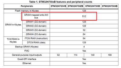

RAM_EXEC (AXI-SRAM) size is incorrect: 1MB!! It should be 512kB:
From the datasheet:
Check also your map file and find what needs to be located in that memory and what is not.
