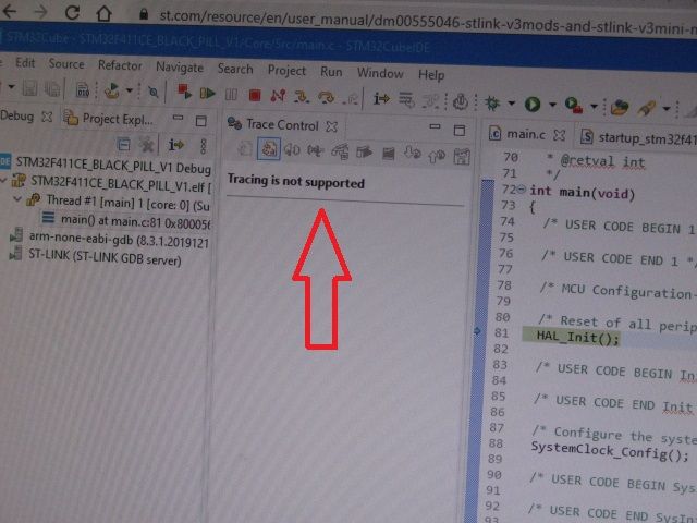

I am trying to get tracing working and when i start the debugger this window pops up saying "Tracing is not supported".
Any one have any idea what it means as i can't find any reference to it.
I have a STM32F411CEU6, watched many how videos and configured everything.
I have STLINKV3MINI with latest update, Cube is Version 1.6.
Turned on all the features I need to but Tracing I guess won't run as somewhere/how i have not enabled something.
I have added SWO wire to the the B3 pin/STLINKV3MINI and can see it streaming data on my scope
Any ideas please as i have spent five days trying to get this to work =)
Many thanks in advance imk

2021-03-14 2:03 PM
Not sure what exactly you want to trace, but check out the SWV Views and app note AN4989 "STM32 microcontroller debug toolbox" to get an idea what's possible.
hth
KnarfB
2021-03-14 2:45 PM
Hello KnarfB and many thanks for the reply.
I am trying to do a "SWV Data Trace Timeline Graph " tracing of a variable in the main loop.
Same as in this ST video https://www.youtube.com/watch?v=eumKLXNlM0U.
But in five days of trying i have been unable to get the graphic or data traces to show and results.
The Live Expression of the variables works as expected, but nothing from the SWV trace.
I think i have found a bug in this Three Week old 1.6 version of Cube or STLINKV3 both of which are new.
As all the video of previous versions with STLINKV2 seem to work.
So not sure what to do, maybe order up a STLINKV2 and install STM32CubeIDE 1.51
Have you got it working and what hard/software versions please?
Many thanks Ian
2021-03-15 1:36 AM
I checked my setup today with STM32CubeIDE Version: 1.6.0 Build: 9614_20210223_1703 (UTC) and two Nucleo boards: F446RE (ST-LINKV2) G431RE (ST-LINKV3). No external ST-LINK though.
No issues, both worked as expected. The TrueStudio video is more detailed and applies to CubeIDE as well: https://youtu.be/XhBiDykSS4I. Double check that the core clock in Debug Configuration and SWV Views match. You may also try with low(er) SWO clock to rule out electrical issues.
STM32CubeProgrammer also supports SWV ITM_SendChar (printf redirection) and you might use that as a somehow independend check.
hth
KnarfB

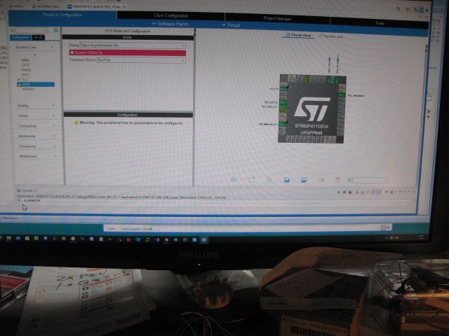

BTW what should i be setting up in .IOC SYS Mode and Configuration please as i get a red bar warning.
see photo

2021-03-15 7:26 AM
Hi Ian,
glad you found it.
The red bar warning only means that you cannot activate that feature (wakeup-pin) because the resources are already allocated elsewhere. Hovering with the mouse over the bar should reveal a more detailed explanation.
hth
