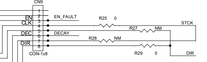

From the hardware point of view you can select the two different control lines for STCK (set the motor speed) and DIR (set the motor direction):
To set the voltage value at the STSPIN820 REF input you can put in high-impedance the correspondent GPIO and use the R7 trimmer to set the Vref and then motor torque (the maximum value is 0.5 V with VDD = 3.3 V).
The step mode (MODEx pins) and decay mode (DECAY pin) are in common for the two boards.
in case you want to make these parameters different, an extreme solution is remove the connector pins and use the on board switches (S1, S2, S3 and S4).
Let me know if these info are useful to you, if yes please "Select as Best" button.
