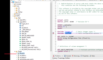

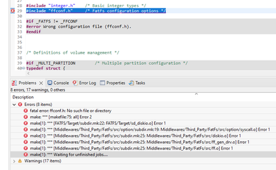

I recover from a project but when I compile there are errors.
And yet this file exists in the project
I think that in this tab the configuration is not correct, how can I change the configuration so that it is taken into account in my workspace ?

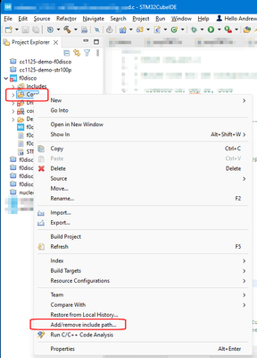

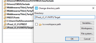

That path has a leading slash - you probably don't want that.
The easiest way to ensure that a folder is correctly included in the Include Paths is to right-click that folder, and choose 'Add/remove include path...'

When compiling there are errors, and the file is configured like this, I haven't modified anything
@Andrew Neil wrote:The easiest way to ensure that a folder is correctly included in the Include Paths is to right-click that folder, and choose 'Add/remove include path...'
I'll try this option to see.
