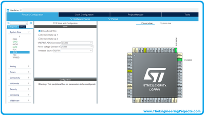

Just open the .ioc file of your project and select the pinout view and you will have a picture of the MCU that is used for this project:

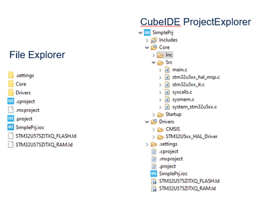

You can also have a look at the name of the .id files of your project:
Ps: it will tell you the MCU and not the board but generally, each MCU is used on only one board.
I think also the recommandation of opening the .ioc file in text editor and look for the name of the board directly is the best as said @Pavel A. if the project is based on a .ioc file. If not, the name of the .id files are the best way.
