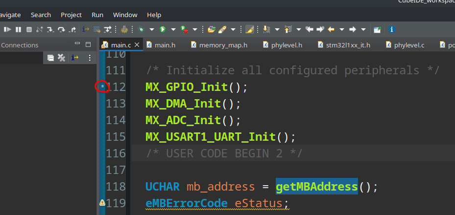

I'm really uncomfortable keeping track of such small icons, which are also almost the same color as the background.
I tried to find the brkp_obj.png file in the /opt/st/ directory (as suggested on stackoverflow), but did not find anything similar.
Is it possible to change the size and color of this icon?

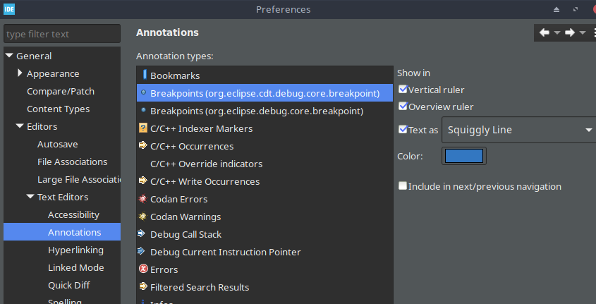

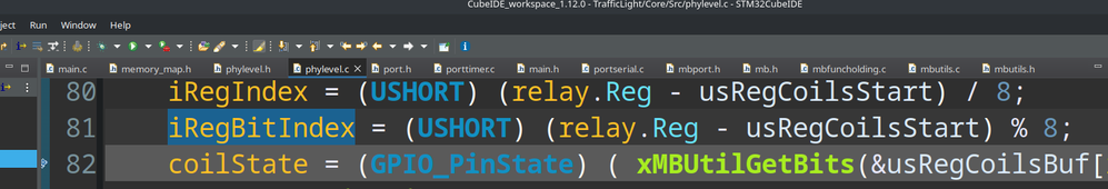

right....i dont know, how to change icon - but you can mark the line ->
in menu window -> preferences ->
then looks like:
or

And this is what a breakpoint looks like with step-by-step debugging. It is practically invisible behind the arrow...:crying_face:
then looks like:
or
2023-04-03 12:18 PM
Thank you. So much better than with a tiny dot!
