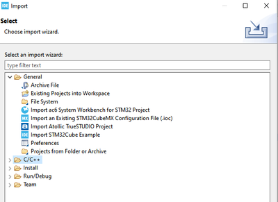

@Pavel A. wrote:Then import the project into that workspace.
Hi.
Which import option to choose?
Without RTFM impossible to import ?

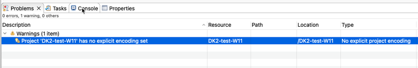

2025-01-22 1:11 PM - edited 2025-01-22 1:16 PM
* If the project is created for CubeIDE or already converted to CubeIDE: choose "Existing projects into workspace".
* If the project is for SW4STM32: choose "Import ac6 ..." Unless the imported project is in the Projects subtree of a Cube firmware package. Then it is an example, so use "Import STM32Cube example". This will open a special GUI.
* If the project is for Atollic, choose Atollic.
* Else it is not importable automatically.
As for "No specific encoding" - ignore it.
