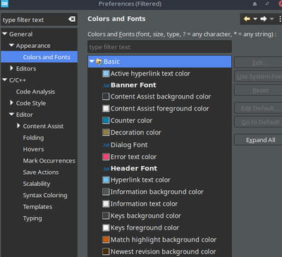

2023-09-09 7:47 AM
try here :
2023-09-10 9:16 AM
Thanks, but none of those affect the background colour in the editor windows. None of them match the background colour in the editor windows either, which for reference is RGB 47,47,47.

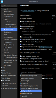

2023-09-10 11:20 AM - edited 2023-09-10 11:21 AM
should be here : + de-select : system default !
but maybe color from system because :
- so change color in system settings (try... :) )
2023-09-11 4:21 AM
Thanks. I have checked the system colour, the background is full back (RGB 0,0,0) so it is not being picked up from there. The "System Default" checkbox is unchecked.

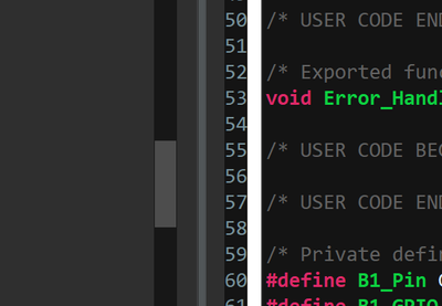

I did discover something interesting though. Have a look at this:
I have the window split vertically, and the cursor is on the right side. The background colour is not the same in each window. The one on the left is my setting. As soon as I move the cursor to the left side, the colour changes to match the right side.
So it looks like the background colour setting you mentioned is used, but then overridden. My guess would be something in the syntax highlighting code is doing it, and moving the cursor to that window causes it to refresh.
I can't find any option in the syntax highlighting bit that corresponds to this grey colour though, so I can't find where it is coming from.

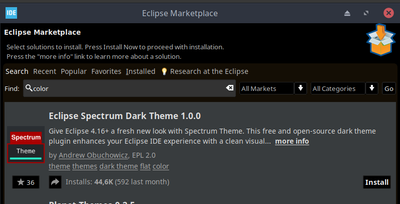

2023-09-11 7:22 AM
maybe now we know , because - from eclipse team:
By design we do not allow the editor background to be changed by the editor color theme as we believe the UI should have a consistent background color.
BUT we can load plugins... menu -> help -> eclipse marketplace : search: color
-- install is your own risk :)
